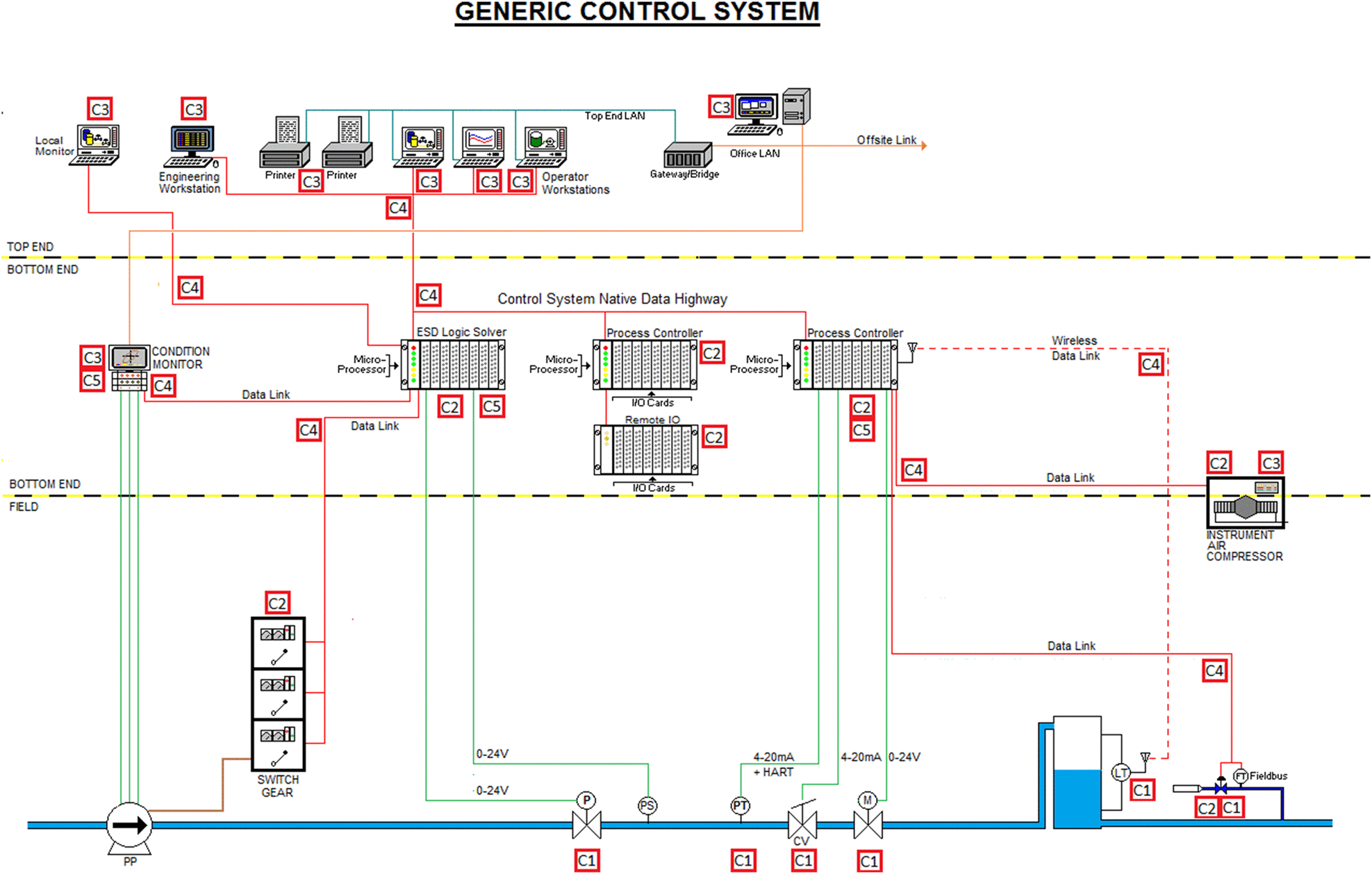

The following provides a more detailed explanation of the above, with Fig 1 indicating how each clause (indicated by a red box) relates to a typical control system architecture.
Fig 1: Relation between the five definition clauses and a typical control system
Clause 1: Extends the definition of an IACS to cover instrumentation and would include Highway Addressable Remote Transducer (HART), wireless instruments and smart instrumentation (including field bus).
Clause 2: Extends the definition, so that it is not limited to programmable logic controllers, Distributed Control Systems (DCSs) and Supervisory Control and Data Acquisition (SCADA) systems. It includes all programmable devices used to operate final control elements such as: full field bus implementations (were the ‘process intelligence’ is distributed through smart instrumentation); embedded control systems; smart switchgear protection, control devices etc.
Clause 3: This includes all human–machine interfaces in the definition be they centrally located in a control room or embedded within the processm plant.
Clause 4: Accounts for the numerous different generic and proprietary communication protocols (e.g. Modbus, OLE for Process Control (OPC), HART, Bristol Standard Asynchronous Protocol (BSAP) etc.) used in the field of industrial control.
Clause 5: This is an important clause as it includes equipment that may not at first glance be relevant or appear on any control system topology diagrams. For example, plant condition monitoring equipment (e.g. vibration monitoring) that is used not only for remote monitoring, but also for plant protection via a hard wired input to a DCS.

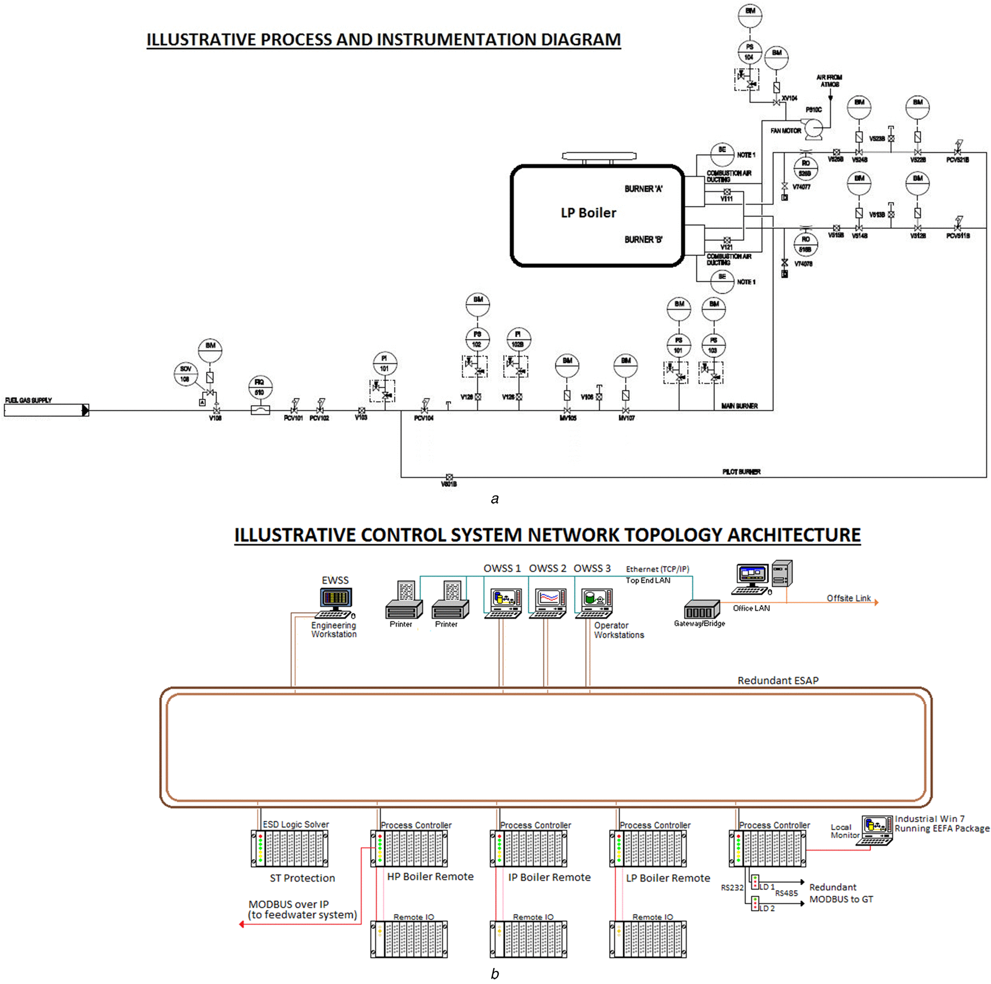

The second point, regarding network topology diagrams and P&IDs, is also important, for two reasons. Foremost being that P&IDs (as exemplified in Fig 3 a) are the base document on which all process and functional safety assessments are made – therefore, are invaluable in assessing real risk (real risk being the risk to the processm). In addition network topology diagrams (such as the example in Fig 3 b) do not include all control system components (such as wireless instrumentation) that fall into either this documents definition of an IACS or that in IEC 62443 – as explained later, structured analysis of P&IDs is a better vehicle for identifying the entire scope of the IACS.
Fig 3: Typical P&ID and network topology diagrams
a) Typical P&ID used as the starting point for a process approach to assessing risk
b) Typical network diagram used in a non-process approach to assessing risk

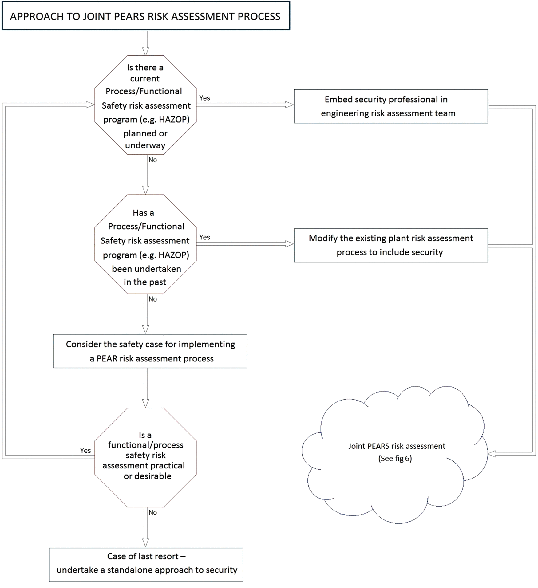

High-level risk assessments are the common starting point for both process/functional safety management systems and CSMSs – in functional safety, a HAZOP may result in further LOPA studies; similarly, IEC 62443-2-1 identifies the need for both a high and detailed risk assessment [17]. Although, ‘HAZOPs’ have been used as an example throughout this document – it is just that – ‘an example’. IEC 61511 is not prescriptive as to the form that high-level functional safety risk assessment should take [18], neither are process safety risk assessments necessarily driven by a functional safety requirement. It is, however, by combining the high-level security risk assessment with its functional/process equivalent that the benefits identified in the last section are derived.
The first step in the process is, therefore, to define where the processm facility is in relation to completing some form of process/functional safety risk assessment, for which there are three outcomes:
  • the facility is about to embark on a plant-wide risk assessment;
  • the facility has completed a plant-wide risk assessment in the past; or
  • the facility has no plans to risk assess the plant.
Of these three scenarios the first is the easiest to accommodate, is also the entry point into Fig 5 and 6 flow diagram. As already discussed, there is little difference between a typical process/functional safety risk assessment and those described in both IEC 62443-2-1 and ISO 27001, as they all involve: a group of relevant and qualified professionals, logically analysing schematics, against a set of guided questions, and recording the outcome in a structured risk register.

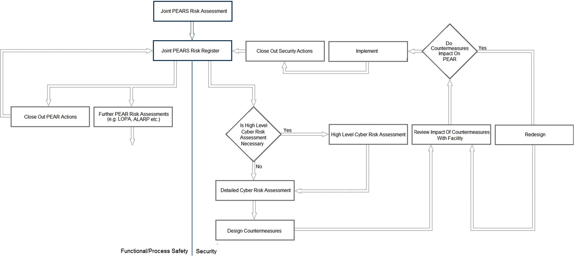

Fig 6: Flow diagram for the integrated risk management system
By including information security professionals in the processm risk assessments they are given the opportunity to understand real risk, while at the same time identifying the precise scope of control system equipment associated with each processm sub-system, by virtue of the fact that the relevant engineering disciplines, with the requisite level of knowledge required are represented in these forums.
On completion of a high-level processm risk assessment, it is usual for the actions to be cleared by the various relevant engineering discipline, overseen and coordinated by the process/functional safety profession. This approach equally applies to the inclusion of security professionals, who based on the combined PEARS risk assessment, are then able to independently undertake their next step cyber risk assessment.
IEC 62443 recommends that the cyber risk assessment process should be a two-stage process starting with a high-level risk assessment (requirement 4.2.3.3), followed by a detailed cyber risk assessment (requirement 4.2.3.9) [19]. If the combined PEARS risk assessment is suitably structured, there is no reason why it should not satisfy requirement 4.2.3.3 [20], allowing the cyber risk assessment to move onto the detailed risk assessment phase, during which the impact of factors such as CIA and vulnerability should be considered.
