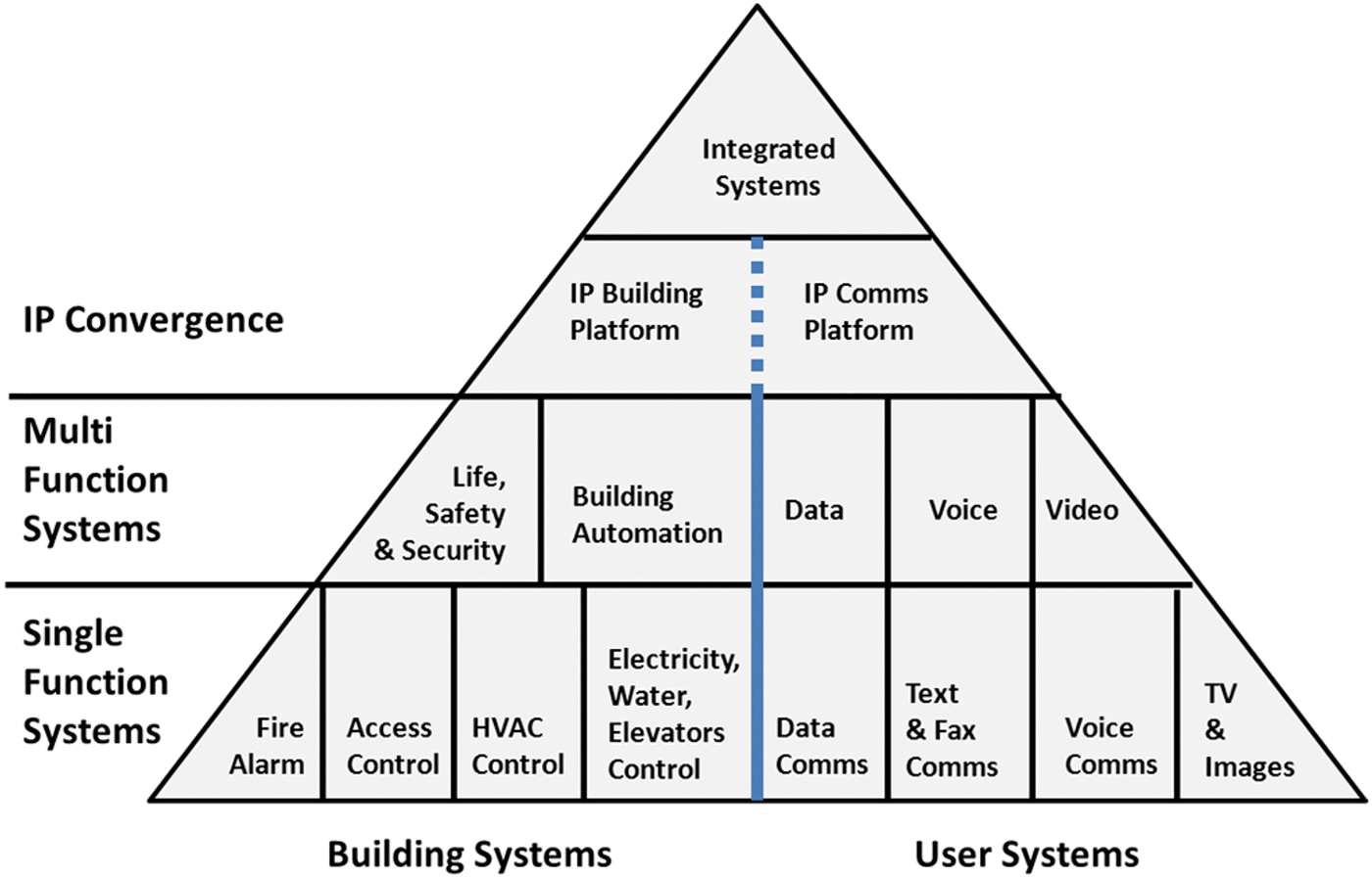

The concept of intelligent buildings is not new. Clements-Croome [2] notes that the term ‘intelligent building was first used in the United States in the early 1980s and that a definition given by the Intelligent Building Institution in Washington was: ‘An intelligent building is one which integrates various systems to effectively manage resources in a coordinated mode to maximise: technical performance; investment and operating cost savings; flexibility’. The innovative idea of a building operating with a converged technical infrastructure as a ‘computer integrated building’ was first proposed by DEGW/Teknibank [3], as illustrated in Fig 1. Putting their pioneering work into perspective, this proposal for the convergence of systems based on an IP-network infrastructure was published before the Ethernet (TCP/IP) was generally accepted as a universal protocol for communications, before the creation of the Internet as we now know it, and several years before any commercial trading took place on the Internet.
Fig 1: Infrastructure convergence – the integration pyramid [3]
Since this early work by DEGW and Teknibank, there have been a number of definitions of what is meant by the term intelligent building. For example, Ehrlich [4] defines it as ‘use of technology and process to create a building that is safer and more productive for its occupants and more operationally efficient for its owners’. This definition reflects the needs of owners and occupiers, but does not explicitly address the environment. Another definition is offered by Harrison [5], an intelligent building ‘provides a responsive, effective and supportive intelligent environment within which the organisation can achieve its business objectives’. Underpinning these definitions is the Integration Pyramid model and increasingly through IP convergence, the integration of the multi-function building and user systems with business systems.

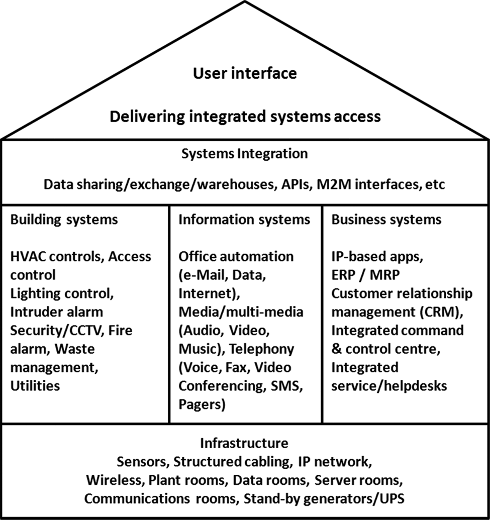

The range of systems that may typically be integrated within an intelligent building is illustrated in Fig 2 [6]. For a building to be intelligent it is not essential for all of these systems to be present, integrated or to share a common infrastructure. It is the systems integration and sharing of data to deliver additional functionality that creates an intelligent building.
Fig 2: Typical systems in an intelligent building
It is important to recognise that wireless technologies play an increasingly important part in the network and communications infrastructure. The term ‘wireless’ in Fig 2 is used as a generic term to cover communications and data links which do not require a physical connection, technologies currently employed include Wi-Fi, Bluetooth, ZigBee, radio, NFC and RFID. The inclusion of IP-based applications is relevant where they interact with building systems or sensors, for example, RFID for tracking location of material or assets. The business systems are relevant only to the extent that they are integrated with building systems, for example, the use of CRM systems to manage access control, or the use of ERP/MRP systems to support supply chain management such as consumables and utilities.

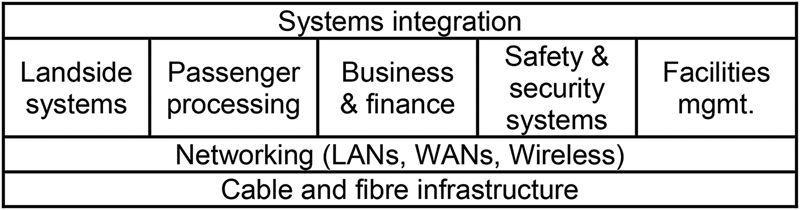

Modern airport terminals are now typically delivered with a converged IP-based network infrastructure [8], based on a common cabling system. This networking infrastructure is required to support a diverse range of operational, business and facilities management systems as illustrated in Fig 3. Economic pressures for operational efficiencies have created a demand for increased integration of applications, which allows streamlined handling of data and eliminates the need for data re-entry thus reducing risks of errors.
Fig 3: Terminal-related IT systems architecture [8]
By adopting common, compatible physical distribution and networking layers in the architecture, as shown in Fig 3, the systems delivering applications use industry standards protocols to communicate between any distributed elements and via the systems integration layer, with one another. For example, from a central control room, an operator may be able to control landside systems using dynamic signage to provide directions for passenger vehicle traffic. Using sensors in parking bays, the system may then automatically indicate to drivers the location of available parking spaces. If a customer has pre-booked parking, a space may be allocated and barrier access controlled using CCTV and ANPR (ANPR – Automatic Number Plate Recognition) systems. The security of the terminal and its adjacent highways and parking areas will typically be overseen from a security control room, using IP-based CCTV and security systems. From a security perspective ANPR may be used for the identification and monitoring of suspicious vehicles in the public highway and terminal approaches. From a safety perspective tampering with or failure of signage on vehicle routes could cause vehicle accidents and injuries to pedestrians.
Within a terminal, sharing of passenger data between systems may allow Internet check-in, make baggage handling more efficient, and allow the customs and border security staff to monitor arrivals and processing of passengers. In addition to the use of IT systems to provide travellers and visitors to the terminal with up-to-date arrivals and departures information, customers increasingly expect to have Internet access with public access in terminals and Wi-Fi readily available both land and air side.
In the airport terminal, a common infrastructure will typically be used to support a range of network-based services [8], including: CCTV, access control systems, fire alarms, badging systems, computer aided dispatch, incident management and visa and passport control. Given an operational need to flexibly manage terminal accommodation, particularly in public areas, the building management systems, internal signage systems and access control systems are all likely to use this common infrastructure. Through appropriate systems integration, this allows passenger flow in corridors and stairways to be switched between arrivals and departure areas to suit the operational needs of the airport. From an environmental perspective this integration may also allow the heating, lighting and air conditioning of areas to be reduced when they are not in use by passengers.
This integrated infrastructure will also be used to support the operation of the terminal from a business perspective, for example, to provide HR services, staff email and internet access, asset management and so on. There may be some integration of business systems and security systems to enable flexible management and allocation of staff, based on their skills and security clearances.

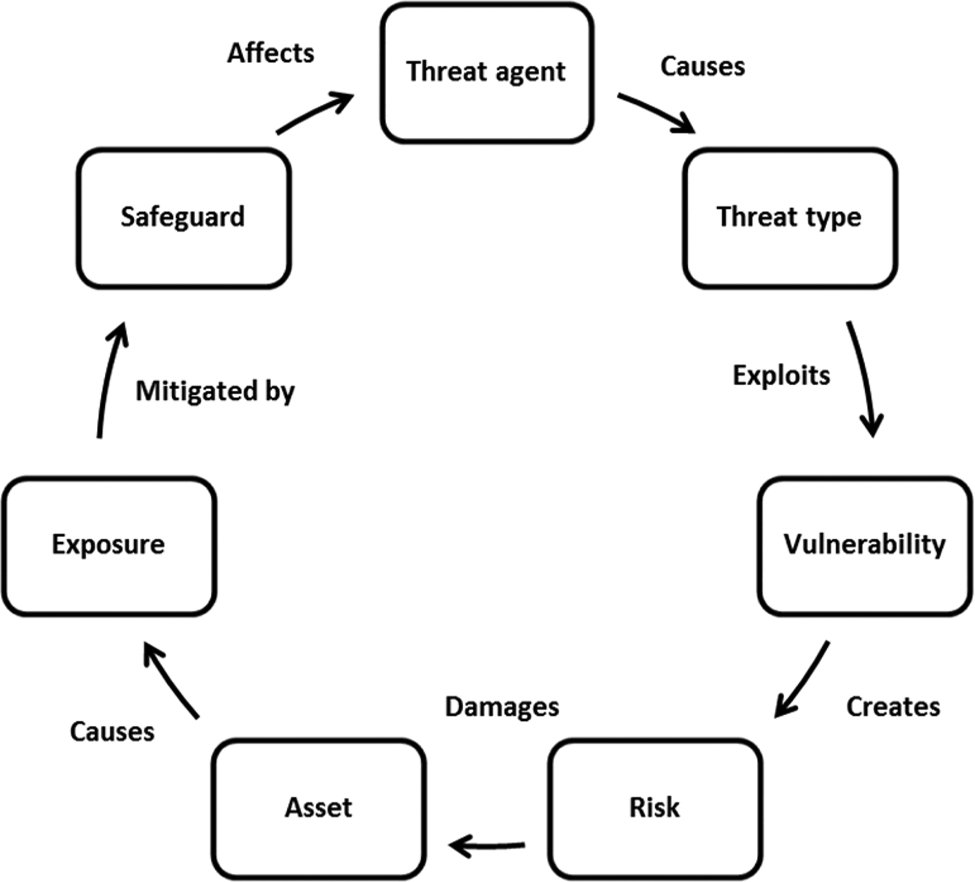

To identify and address potential cyber security vulnerabilities a risk management cycle [15] will typically be used as illustrated in Fig 4. The objective of using this cycle is to analyse potential threats, allowing development of proportionate safeguards to enable suitable mitigation to be put in place. When considering cyber security related risks affecting an intelligent building, the owner/operator can choose to avoid the risk, to reduce the risk, to share it or to retain it.
Fig 4: Typical risk management cycle
In an international airport terminal maintaining security of the air-side/ground-side interface is critical for effective immigration and customs control and to deter the air transport related terrorism. It is essential that availability and integrity of these systems are maintained. The design of new security systems (access control, CCTV and badging systems) are TCP/IP network based. If, for example, following an assessment of vulnerabilities, a terminal owner/operator may determine that the following cyber security vulnerabilities should to be addressed as they could lead to physical security breaches:
  • the potential for loss of systems availability because of mains power failure;
  • the use of wireless networking would be susceptible to jamming or interference thus affecting network availability; and
  • the risk of unauthorised access and data corruption if the security systems infrastructure is not adequately protected where is passes through public areas. This may affect both confidentiality (access control) and integrity (of systems data).
In assessing risks associated with these vulnerabilities, the terminal operator can decide to avoid the risk through the following measures:
  • to prevent power loss, supply these systems with electricity from an uninterruptible power supply supported by back-up generators;
  • to only use cabled networks thereby eliminating the risks of jamming or RF interference; and
  • to avoid unauthorised access in public areas, the cables may be routed via secure distribution ducts preventing physical access to the cable distribution system. Alternatively, the terminal owner/operator may choose to implement appropriate network security measures (e.g. firewalls, intrusion detection systems etc.) to maintain flexibility while reducing risk of attacks from outside the secure area.
